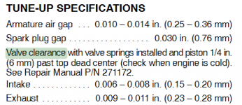

Okay, that will have to be something I check into tomorrow afternoon with the right tools.
Any idea what the feeler gauge should be set to and what the torque spec is buttoning everything back up?

If my engine manual and my riding mower manual have different clearance specs which one do I use?
