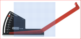

Trust me, 25 psi in the front tires is way too much. Every lawnmower I've ever delt with was close to 10 psi rear and 14 psi front. Also, when leveling the deck, shake it after making any adjustment as it could be hung up or tight and this will make sure it's moving during adjustment. This tool also works very well if you don't have one.View attachment 66458

I ordered one of these and works great

I have the same one! It does work great!
