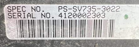

Which are referring to? The two nuts holding the air filter base to carb studs or is the two that the shroud on to the air cleaner base?
The nuts are M6-1.00 and the two shroud bolts( screws) are M6X1.7X18 Plastite screws which are not common screws. Both would be removed using a M10 socket.
The other four shroud screws are M5-0.8 x 16 thread forming screws. Which are removed with a M8 socket or wrench.
