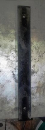

Of greater concern is the piece of metal found on top of the deck - 8.75: long, holes 7" apart, with witness marks each end. I cannot see where it has come from. metal piece.jpgwitness marks on metal piece.jpg
Can anyone please point me in the right direction for fixing this, and identifying the mystery part and where it might have come from?

I'm pleased to advise i have been able to answer my own questions, as follows:
1. The reason for the odd configuration of the cutter brake bell crank was that the threaded rod that goes to the front of the mower and back into the U piece that attaches to the top of the bell crank had been pulled so hard the spring had bound and the end of the rod had been pulled out of its hole and was jammed against the cross piece. Easily fixed once it was out.
2. The plate with the threaded holes is an Engine Mounting Bolt Plate. The engine mount bolts go down through the engine deck and screw into the plate. Need some Loctite for next time. If there is enough clearance I'm going to get longer bolts so I can put Nyloc nuts on so it can never vibrate loose again. So lucky it fell into the enclosed area on top of the cutter deck which has 4 metal sides.
