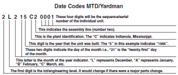

I had downloaded PDF document MTD Form No. 769-05383 (May 13, 2010); shows on pp. 40-41 part 34, as 946-04670 (pages 2 and 3 on the truncated file I've attached).
  • Troy-Bilt parts list TB130 edited 2.pdf
98
11,760
You got realize that you have a 2017 mower in front of you so a 2010 IPL is no good; unless, it is a 2007 model. But what 1 am finding none was built in 2007 with exact model number you posted.
Cusser
May 3, 2019
14
225
No, I didn't know it was a 2017 model, it was given to me by a neighbor; but now I do ! Thanks.
