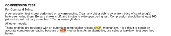

Sure, if it's an old battery. Some of the service manuals are for an engine family. I had a Kohler engine like that where the manual implied there was an acr, but I was told by people who should know, there was none.

. Service manual says it has an ACR but I wasn't able to identify it on any diagram I could find.
This is what confuses people and should be removed from the Command service manual
The all other models parts gets people into trouble. The Command twin doesn't use ACR therefore the high compression and the fact you can do compression testing on the command engines. And also due to the hydraulic lifters an ACR wouldn't work because the lifters would bleed down and would override the lift of the ACR.

I have yet to invest in a compression tester. Looks like now is a good time. Manual says engine should be warm. Suggestions on how to get it running? What does it mean if the compression is low? Problems with the rings?
