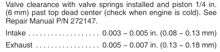

Your valve clearance settings are wrong. Per your Briggs engine manual below.

Intake top 004
Exhaust bottom 006
