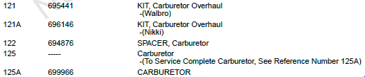

I have a customer’s Coleman Powermate 6250 generator with a B&S engine (pull start only). The carb needs to be replaced but I’m unable to verify the correct part number. I’ve tried looking on B&S website and jacks small engines and I’m not confident the carbs I’m finding are correct.
The photo shows the only ID tag I could find on the engine. I can double check but I didn’t see anything stamped on the valve cover.
It’s a Nikki carb with 697078 stamped on it.

Try looking at the bottom of the valve cover for the model number, as someone may have have removed the cover and put it on upside down. If not there post a couple of pics of various parts of the shroud which may help us identify it.

As usual the necessary numbers are in the “most convenient” place to see/read. :)
Model 204412
Type 0156E2
Thank you.

PN 699966 superseded to 591378
