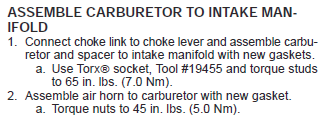

Well it is pretty dead simple.
It is getting the governor link into governor lever that is a little bit of a hassle as you mount the intake manifold.
Socket is a E5.

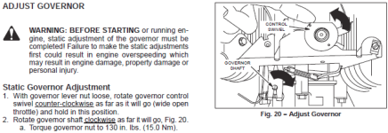

Most likely it is the governor linkage. Check the diagram and make sure you connected the linkage correctly. Is there a spring or springs for the governor? Is it connected correctly? Or, are you missing a spring?
11,397
It may need the static governor setting set, But first make the governor arm moves the throttle shaft on the carb.
Everything moving as it should after the adjustment and it still runs away either the carb is on backwards (kinda doubt it) or the governor has failed.
