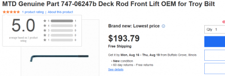

Note the lift rod is currently on back order from MTD and some vendors are posting ridiculous prices for the under $15 part just to keep an ad up. Here is an example of this.
But can you local shops and they might have an used part laying around.
