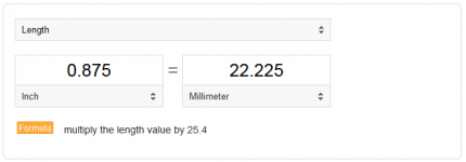

I measure the shaft with appropriate tools and the shaft is 22 and 20 mm. For what that is worth.
