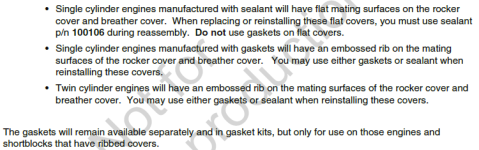

From Service Bulletin 746.
It is to note that on OHV engine the rocker clearance should be adjust to the minimum clearance to extend time between adjustment periods as the valve train will wear and increase the rocker clearances.
Also note when applying RTV the rocker cover screws are only install finger tight for the first 12-24 hrs. Also you are not to start the engine during this time as the oil will prevent the RTV from curing properly. Once the initial curing time has pass then the screws are torqued to 65 in-lbs.

That is absolutely perfect! Thank you the information, especially for including what appears to be info directly from a service manual. Are Briggs service manuals available for the public, whether free or for purchase?

You can download a service manualHere. Adjusting the valves every year is overkill, but if it brings you peace of mind, then it's fine. The recommended interval is every 200 to 300 hours. I agree that Permatex is a pain to clean but rarely leaks if installed properly. I use a flat plastic razor held vertically to the surface, and that works well. I use this Permatex style applicator and it works great. To apply it correctly, apply a bead around the edge of the cover, then install it with the bolts just snug enough to start to flatten the bead. Let it set for 8+ hours and then torque the 3/8 bolts to about 60-70 in lbs. / 5-6 lbs. ft.
