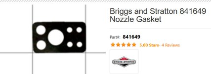

On first start, it ran on both cylinders, but needed a bit of choke to run well. I couldn't figure why it seemed to be running lean, so off came the carburetor again. It seems as though I had misplaced a small gasket. I thought about ordering it, but being me and in a hurry I decided to get a small piece of gasket material and make it myself.
I just gave the mower a run in low 90 degree temperatures and it's running great again. Initial issue must have been some carbon blocking the flow to the right cylinder jet, and the second issue was the missing gasket allowing excess air in leaning the mixture. I'm now hoping for a few years of trouble free mowing.
