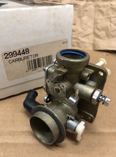

Here is one with your part number on ebay. He wants $19.90 for it pluss $29 shipping. It's supposed to be NOS and is in Hong Kong.
I just wanted to add, you could make an adaptor plate and make a similar sized carb work. I have done that with several engines.

yeah that doesn't even resemble what's left of mine so I will pass on that one thanks
