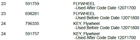

The flywheel must be ordered via the date code as Briggs redesign both the flywheel and crankshaft keyways.
One problem is 698281 is NLA so you must upgrade to the newer flywheel and crankshaft if using new parts.
And the new setup uses a double length key.
So it is just a lot more involved and expensive to do this.
