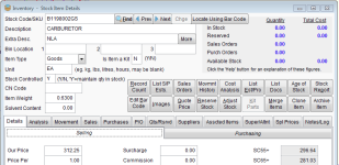

Just got a response to my email to Briggs & Stratton. I've already searched for the carb part number to no avail. The email says:
Hello,
Unfortunately, not seeing any carburetor overhaul kits available, and Briggs and Stratton is showing the carburetor as no longer available with not alternative. Float bowl gasket is showing to be no longer available as well.
The carburetor part number is 198002GS, I would suggest a web search and see if any other outlets have any remaining stock.
Thank you,
Briggs and Stratton Online Store
