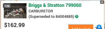

Briggs is showing...
125 being ref number: 84004885 Used Before Code Date 18112600
125A ref number: 84003204 Used After Code Date 18112500

Nikki carburetor 797320 is now 799060 your welcome
