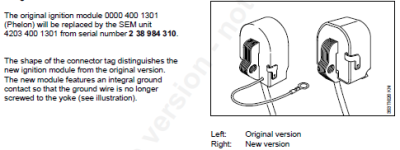

Hello All
Stihl BR400 Backpack Blower
Replacing the coil. The original has a wire coming out of the housing which the new aftermarket ones don't have. I am talking about the wire with the eye loop at end. Do I need to care that the new ones don't have this wire?

This should answer the question.
