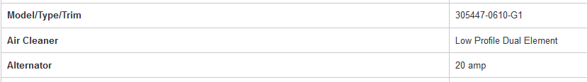

I just wanted to know the amperage of the the system, allegedly from colors , Engine 3054470610 G1, as stated ,colors don’t mean anything anymore.
110
12,249
Okay here is what we are looking at PN 846882..
And according the Brigg Power Portal it is a 20 amp setup.
