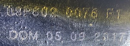

Have a Bolen (MTD) 21" push mower. DOM May 9, 2017. Engine Model # 09 P6 02 0076F1. S/N:17 0509 51 34567.
Mower maintained regularly since purchased. Pulled it out 2 days ago, will not start. Weak spark, opened top end & cleaned flywheel & reset air gap, new plug, Great strong spark. Still won't start. FUEL Starved, bone dry new plug. Can start on 1 or 2 pulls, if I put fuel directly into carb or spark plug hole, but dies as soon as it burns it off. Found a fitting on the carb that appeared to be missing a hose, but extensive searching found that apparently it is just a vent fitting that never had a hose attached to it. Fuel is fresh. Flushed the carb, but still not getting fuel. Found another posting about a fuel starved carb that turned out to be one of the fuel line fittings between the tank & the carb blocked solid from an unknown substance, possibly the fuel additives in the gasoline (like e10, e 15), so will now be pulling off the line between the tank & carb to check for a plugged fitting as that other owner had found. The biggest annoyance I have found is with the numbering system Briggs & Stratton uses & the amount of revisions they have for parts & trying to figure out how the date codes next to the parts work like this one:

Model Number and DOM Cropped.jpgModel and Serial Number.jpgInked Vent Fitting on Carb.jpg
Even by my model number, B&S says I have a 500E 146 cc engine when mine is clearly marked as 500E 140cc. While I am NOT the SMARTEST guy in the world, I am FAR from the DUMBEST guy in the world, but their numbering codes have me completely baffled!

According to the model number you posted, you need carb #799583. The code number, aka serial number, is 17 0509 51 34567. Forget the spaces.
