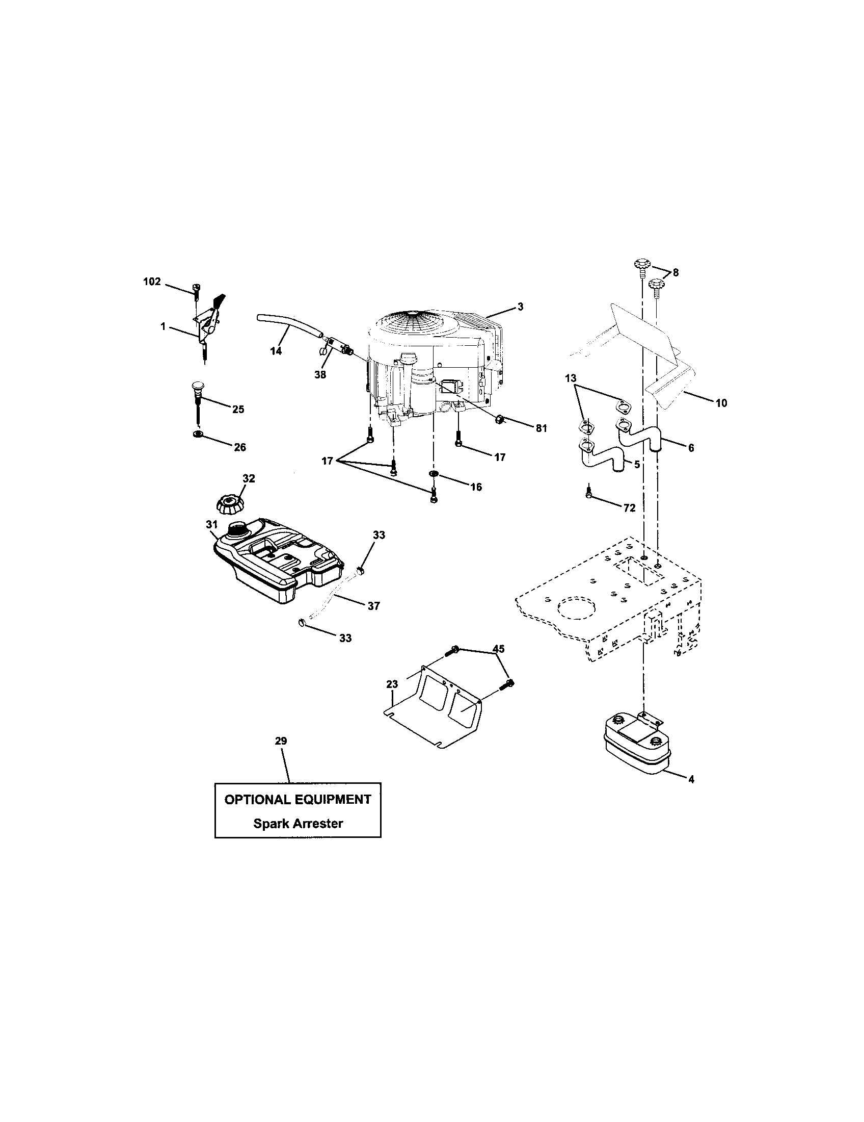

I re-installed the shield and she ran for almost twice as long as before before having problems. I guess I'll put in an order for a new shield and see what happens when I have a complete piece on.
The wing on the side of the shield is roughly 25 square inches in size or about 25% of the total size. Also, the wing that is still attached is barely hanging on (if I flex it once it will probably break off) and felt barely warm when I touched it so it is not doing its job to dissipate any heat.
The heat shield id number 10 in the linked diagram.
http://c.searspartsdirect.com/lis_png/PLDM/P0303056-00005.png

If it is "barely warm" then it is doing it's job. Is it aluminum?
The shield is steel. The barely warm temp was lot less than the main part of the shield. The wing was about 3-4 seconds on a touch test, where as the main part was 1 second on a touch test. The existing wing is only hanging on by about a 1/4 of un-cracked metal.

Here's an update on my issue....
After cleaning out the gas tank again and fully cleaning the carb, along with the new heat shield, she seems to be running without issue and I haven't had her cut out on me. I still have a new breather to put on and have a few questions on that.
