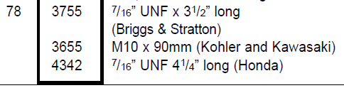

Sounds like you are trying to remove the setscrews (5/16” UNF x 1” long) which should be 5/32 hex bit. And you will need a impact grade version of the driver. Common everyday bits are too soft.
Also the center bolt be SAE or Metric depending the engine used.
The SAE 7/16 uses a 16mm (5/8") six point hex socket.
The M10 would use a 17mm six point hex socket.
