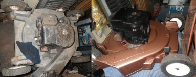

A few years ago someone gave me an early/mid 70's alloy deck Craftsman push mower, it got lost for a bit in the shed but I liked how easy it pushed. I re-discovered it while cleaning out the shed last month and decided to get it running again.
The original motor was swapped for a Briggs and Stratton 3.5hp, which I'm told is for the better?
I got it running as found pretty easily, cleaning the points was all it took to make it run. The blade was like new, I replaced the air filter foam, spark plug, coil, switched it over to Magnatron and abandoned the points, after mowing the lawn a few times with it I decided to make it look a bit better. I stripped it down bare, glass beaded the deck shell, and all hardware, replaced the recoil cord, rewound the spring properly, then gave it some fresh paint. I had a can of copper/gold hammer tone so I gave the deck several heavy coats and I painted the motor with a few coats of low gloss black. A buddy took the handle and powder coated it in bright silver.
I knocked the bearings out of the wheels, sandblasted off the rust, filler primed and painted each one and relubed the bearings as well.
Here's a before and after:
The deck has a through hole below the muffler, from what I read these had exhaust that went out the bottom on the original Tecumseh engine. I have a few older Tecumseh engines, including a 4.0hp off a similar age Sears mower but its exhaust does not exit downward. It appears that the exhaust on these had a tiny tail pipe that came out in front of the muffler and turned down through that opening. I think as a mower its likely better have the BS engine and I'm fine with that part but since I have the right motor, I could make a custom muffler that goes out the bottom. Of course I could also do that with the BS engine too.

I would not make an exhaust exit through the hole in the deck. That would be risky with dry grass clippings. I do not think that was an exhaust hole anyway. Mostly like it was for putting a bar through to hold the blade so the center bolt cold be loosened and tightened as needed.
Nice job on the finished results.
