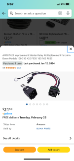

My 54 inch Bad Boy MZ Magnum zero turn riding mower quit on me. It's model BMG5425KO. I turn the key and it just clicks. Battery is good. When I jumped/shorted the starter solenoid, it cranks. I thought it might be a bad starter solenoid, so I replaced it since I had a spare one. Still nothing. It just clicks. I bought an ignition switch from Amazon. Same result. Any suggestions are greatly appreciated. Thanks!
