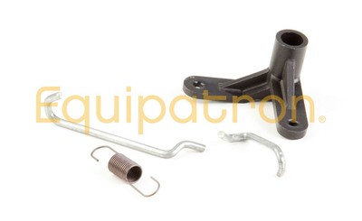

I had to buy a new bell crank for the opposed twin one time, that's what the governor link is hooked to, and there was an extra spring in the kit that said to install on the governor arm to the bell crank if high speed surging happens.

I will have to look into this. Thank you for the advice.
