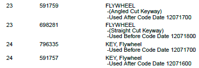

Did you buy the correct flywheel? Briggs changed flywheel and crankshaft designs in middle of 2012. The flywheels are timed differently due where keyway was cut.

It was the mod 571759 ordered from Briggs website and numbers matched the old one but maybe will take off and compare with the old one

Looks like you nailed it, everything is exact except the keyway, about a quarter off, now what do I do with a 200 buck flywheel lol.... Cannot seem to find a different one online but will have to dig deeper, thanks for your help

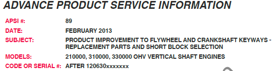

As far as I know the core flywheel is the same just how the keyway is position and cut as is the crankshaft key way and position are done. Below is from the service bulletin APSI 89.
