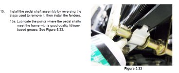

  • / 2009 Cub Cadet LTX 1040's Brake Pedal is Sticking with the Drive Pedal.
Here is a spot to lubricate, but I doubt this is where the issue is. My guess is you have grass clippings in the back portion.
