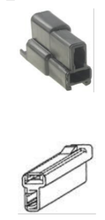

You are looking for the upper connector in the following image on the mower wiring harness. The lower is the one that was described. It will have male terminals inside it.
It may have pull off or cut off and would need replacing. Here I have a modified open barrel crimper due to the standard open barrel crimper damages the male terminals.
