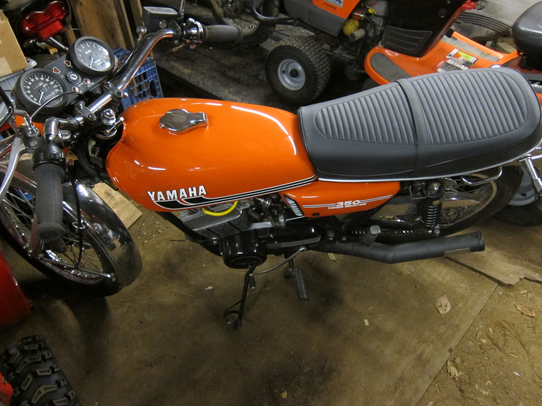

Oh, and another 2-stroke I forgot to mention. This one has 7k+ miles on it since a complete overhaul. Still runs like the day I first started it. Starts 3 kicks cold whether it sat for 8 hours or 8 months, and always 1 kick warm.
This one gets Amsoil Dominator since it's oil injected. I feel Saber is a bit too heavy for the injection pump and could cause issues.
