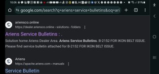

15mins on new ariens IKON 52 from lowes and the deck belt broke. Saw in reviews it was happening often. Asked about the issue and my local lowes mgr and he said selling Ikon52 are on hold because of the problem. Here is a service bulletin I found which shows its a known problem. Does anyone have access to the actual complete bulletin?

SB B-2153 does not cover a deck belt problem but covers a motion drive belt problem. Besides that should have been solved for some time by now.
