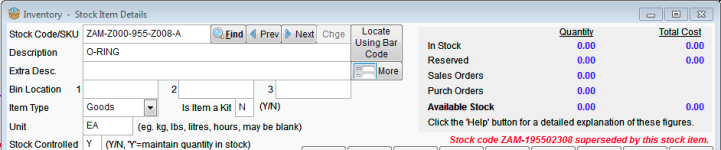

They are still replaceable. It just that most times the carburetor is badly worn too.
But here is the o-ring part number. For its size it is an expensive little part @2.48 USD each retail.
