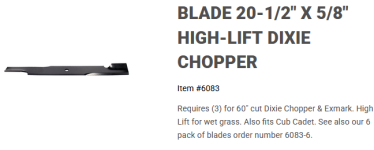

No. I listed the wrong number. It's 6083.The best way to determine which blades that you need is to either get the actual dimensions of the blades or look in the mowers operator manual for the blade number. In your case, you have a 20.5" long x 2.5" or 3" wide x 1/4" thick with a 5/8" center hole.
You can go to the Stens, Rotary, or Oregon websites and input those numbers and you will get several different styles of blades The Rotary 6183 is a notched high lift blade.

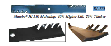

BTW the way this what the BL-724 looks like.

I know. The notched high lift is my personal favorite. We still don't know what mower these blades are going on.
The Stens 362-820 will be close to the Mamba blades.

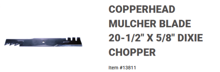

Here's another
I'm currently running this blade on my Gravely.
See, Now that is much better. Since we have the blade manufacture PN and an image of it we know it is not a drop leaf version so it doesn't matter what 60" deck they are going on. Just had to get your train of thought on the right path.
Now those USA blades are the best match so far and they are available thru Amazon in sets of three.
