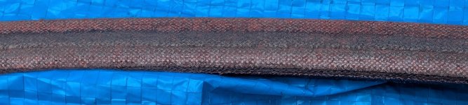

This is the belt from the machine. Red kevlar. The entire length of the "outside" of the belt has a black stripe. I wonder if somehow the belt was inside out on the mower deck. This is the belt that was on the machine up to yesterday. So it is a "V" belt the widest part has the black stripe. The narrower part has some fraying but no black stripe.

I sprayed some WD-40 on the all the pulleys top part and I put the belt on maybe it was inside out it's better but there's still some noise that I can't identify where it's coming from.
