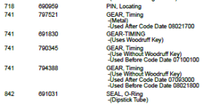

Right now my plan is to replace that crankshaft gear (timing gear?), and of course the engine seals, put it all back together and hopefully that fixes everything. Unless we come to some different conclusions in this thread.
Also, side note. I have the model number of the whole machine itself (247.77013.0) but I cannot find a model number ANYWHERE on this motor. It has a decal that says 675 series, but no numbers. And I need a number to be able to look up engine parts. How can I figure out this ENGINE model number?
