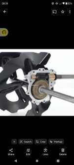

How often should the gearbox grease be replaced?
Husqvarna 924HV
Model number 961930070 00
DOM: 091911 (2011)
Since I have a 10 y/o snow blower when is it necessary? Owners manual implies only if gearbox has been repaired. The only reason I can think of to repair a gearbox is impact with something and shear pins fail or grease failure.Screenshot_20231111-083945.png

From the manufacturer's manual:
AUGER GEAR CASE•The gear case was filled with lubricant to the proper level at the factory. The only time the lubricant needs attention is if service has been performed on the gearcase.•If lubricant is required, use only Ronex ED #1
My thought was to open the fill port and pump grease into the gear box until it overflows. Put the cover back on and repeat again. My concern is the left, right, and rear seat may fail over time and result in shaft damage.
Yes , I have to much time on my hands
