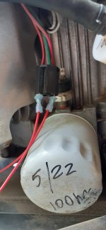

So I pulled the shroud to check the linkages and "Air Vane" and everything moved freely. So looking closer I saw that the thermostat connected to the choke lever so I suspected the thermostat went bad. So, first things first, I disconnected the wire connector and with the key turned on, checked to see if the thermostat was getting voltage with a multimeter.

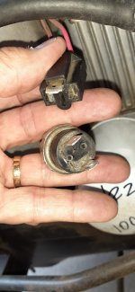

Nope, no voltage detected. So I had to figure out where the thermostat got it's voltage from. Pulled up a copy of the circuit diagram and surprisingly it is being fed by the oil sensor (I never would have guessed that). So, I mosey over the oil sensor and pull the connector and sure enough the ground tab was broken off (picture1). I made a pigtail (picture2) to jump the power over to the thermostat and it started and ran beautifully. I just got the new oil sensor in today and swapped it out and can confirm the fix is good.
