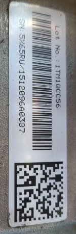

 I have attached pictures of the engine sticker & model number data plates.

Here is the text copied from a sticker on the mower:
EMISSION CONTROL INFORMATION MTD CONSUMER GROUP INC.
EXH FAMILY: FCZHS.1591V1 ECS: EM
EVP FAMILY: FCZHPNHEQCPX, CPXP
DISP: 159CC
ECS: CP
EMISSION COMPLIANCE PERIOD = 125 HOURS
THIS ENGINE MEETS U.S. EPA AND CALIFORNIA EXH/EVP REGS
FOR SMALL OFF-ROAD ENGINES FOR 2015 DOM:12/2015
VALVE LASH(mm):0.10INT 0.15EXH: SPARK PLUG GAP:0.6-0.8mm
OIL: SAE 10W-30 NO OTHER ADJUSTMENTS NEEDED
THE AIR INDEX OF THIS ENGINE IS 3
CHECK THE OWNER'S MANUAL FOR
FURTHER DETAILS
EU: e11*97/68SA*2012/46*3125*01
0 3
MOST CLEAN
10
LEAST CLEAN
8062#
