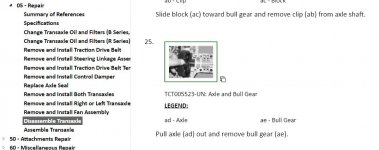

I work at a Deere dealership and looked in the TM127619 tech manual to see if it is indeed incorrect. Unless you are looking in the wrong manual, the correct tech manual (TM127619) for the Z920M does tell you to remove the axle shaft from the transmission to replace the hub seal. It is part of the transmission disassembly instructions. I'm sorry the dealership you contacted didn't take the time to get you the right information. See attached pics.

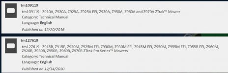

Then they changed the manual since they first publish it. here is a screen shot of the first page of the manual I have.
Also here is a screen shot from the manual

Definitely looks like it has been updated.
