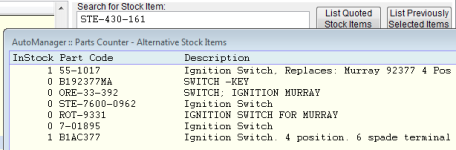

11,476
And here is a list of crosses. And I have the B1AC377 and it matches the make/brake on the schematic.
