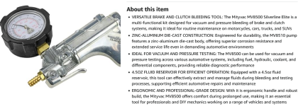

unburned gas in the muffler
Pressure test the carb needle at 7psi for 30 minutes. Your needle sounds intermittent.

Pressure test the carb needle at 7psi for 30 minutes. Your needle sound intermittent.
Hi slomo,
Can you elaborate how you do this?
#9
Hi slomo,
With a pressure/vac tester and the carb inverted. Like my Mityvac 8500

Auto Doc's
Hi slomo and StarTech,
Thanks for uploading examples. Many of our followers are not aware of these strange testing methods that are used to verify carburetor needle a set sealing effectiveness.
