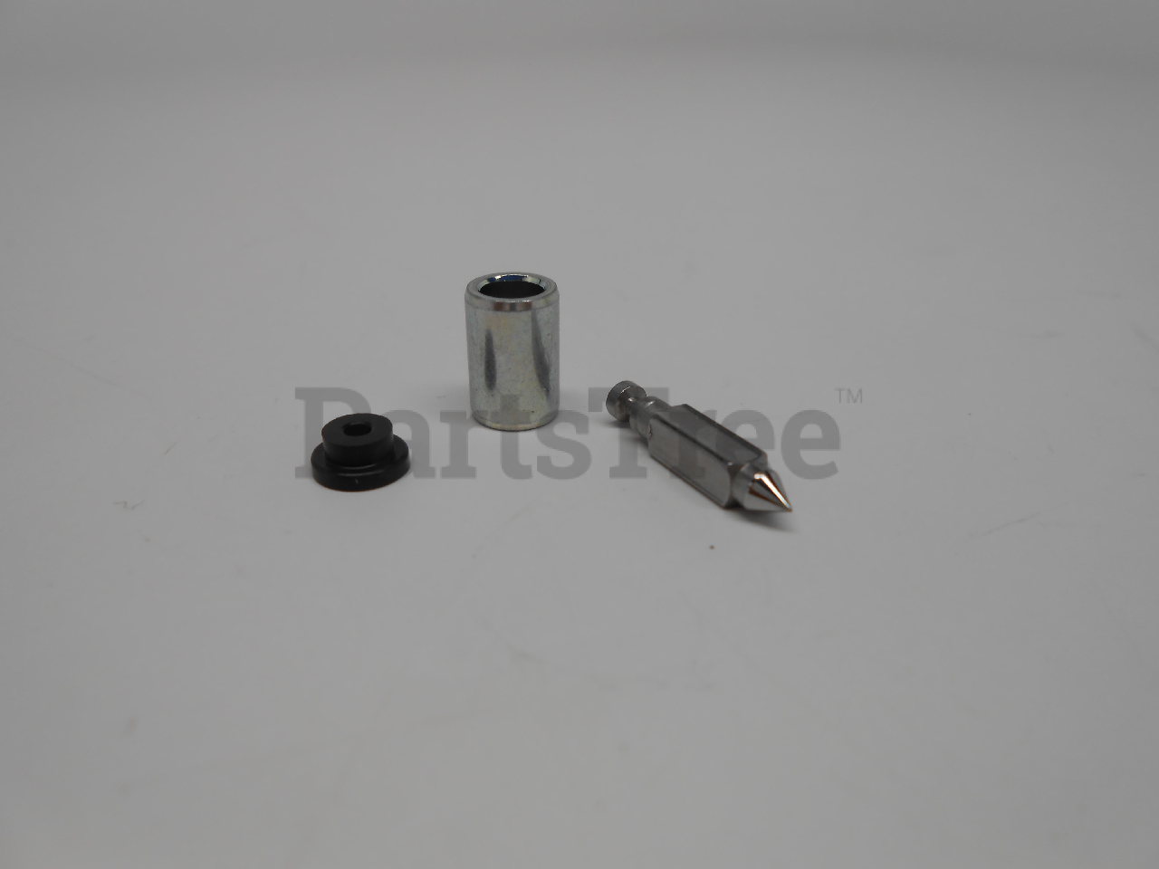

I'm working on a carb leak at float needle on this mower for a friend. It has a Suzuki 5hp ohv #vmk9-230716, w/ Mikuni carb. Picked up parts at local shop. Float needle, seat and metal sleeve in kit ($30+). How do I remove sleeve to replace needle seat, and install new sleeve? Or any source for a replacement carb? Thanks for any help. Mike

You can polish metal seat with a q-tip in a drill and some lapping compound and replace needle. Thoroughly clean carburetor and then if that doesn’t work, go for aftermarket one.
Tiger the problem is the seat is rubber held in what appear to be a metal sleeve and solid needle valve. And no it is not a repower. Since I haven't done one these it is only a guess but the sleeve has to be extracted, rubber seat removed, new rubber seat installed, and the new sleeve pressed in place. Just no instructions in the service manual on how this is done.

Thanks to Rivets and Star Tech for the information. I am familiar with metal needle and rubber seat. Don’t know why you would have to remove and replace metal seat when you normally remove and replace rubber seat by picking it out, like in a Tecumseh.

Tiger, here is one of them:
