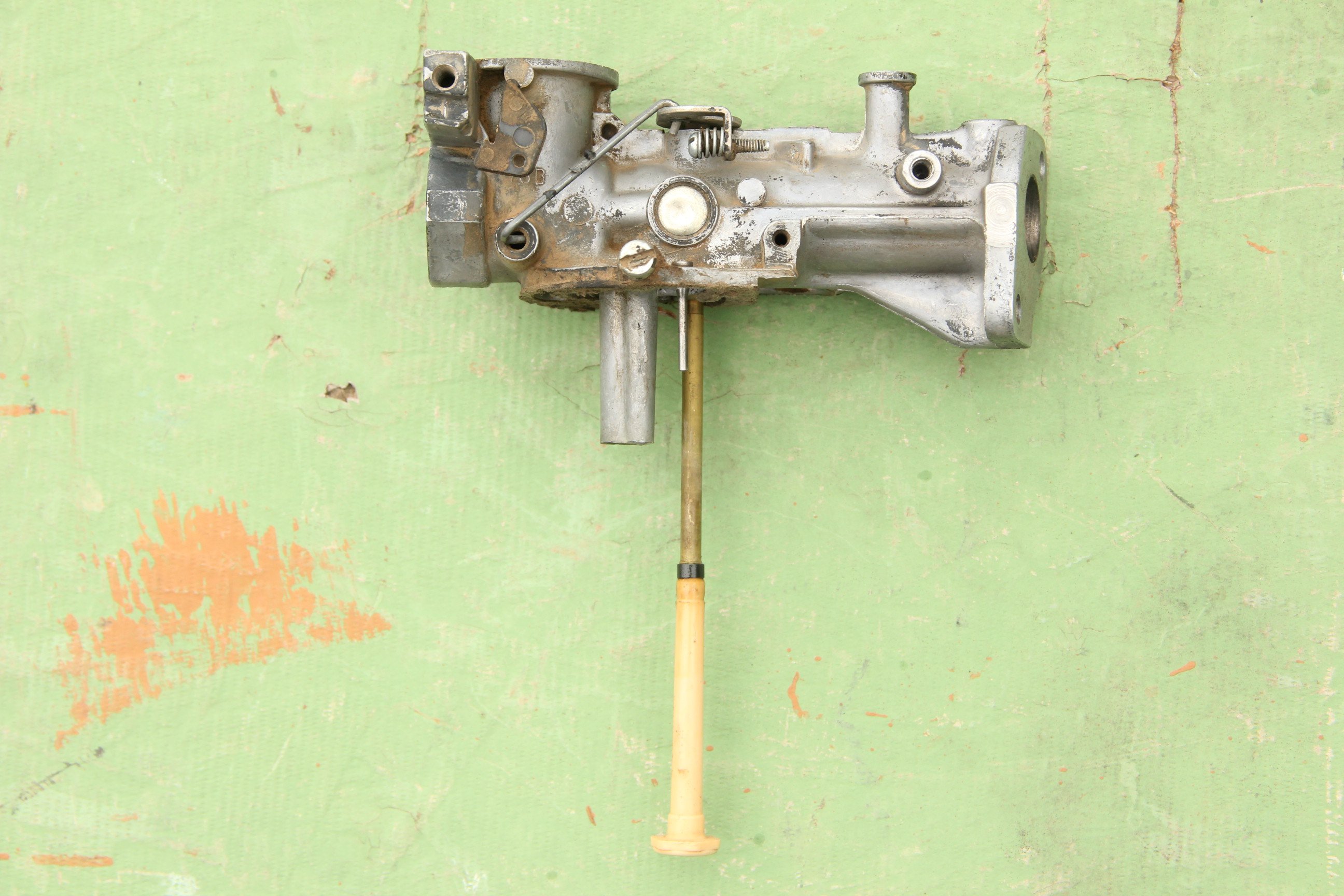

This one looks similar and this part is available.
Just search eBay for 261558 briggs and it shows many new for about $20 delivered
Visually it appears your engine is like a Briggs 135202-0119-01 Date 93012627
I have this engine on my front tine tiller in my garage. It’s similar to yours.
To order the governor link just go to eBay and search for “Briggs 691814” and order it.
Seller says 2-4 day delivery
I ordered the governor control rod late and am waiting for it's delivery.
