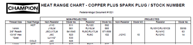

I don't know where that info came from but this is what I have on the RJ17LM plug here. But converting to metrics the specs matches to 9.5mm reach. Just 8mm is very close to 5/16 and I see no Champion with that spec. The .6mm gap is converted .023-.024" which usually gapped at .025". Normally you do have a little leeway on the reach but a not a whole lot; otherwords, you can't go to an 7/16 inch reach.
Now what plug is in there now?
And most time it is okay to install the RJ19LM in place of the RJ17LM.

Thanks. I've attached the instructions. I think I'll take the head off the engine and see if the thread of an RJ19LM sits flush once its screwed in - if it comes through I'll know I have an issue. And I'll set the gap to 0.6mm and see how it runs.

Thread is the diameter of the threading. In this case thread is a M14 diameter.
Reach is the length of the thread section and /or the tip. Example M14-1.25 x 8mm or a 9/16-20 x 5/16. Now there is difference in how this measure is done. In you example they are just the threaded section but in the chart I post they are measuring the threaded section plus the tip. I verify this by actually checking a plug here.
In this case the length from the gasket of the plug to tip the M14 threaded section from the gasket to tip or just the threaded section without the gasket. And measurement with gasket can vary a little depending on how much the gasket crushes. So I would say the RJ17 or RJ19 would be safe to use.
