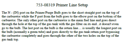

Here is the instructions I have the 753-08319 primer setup. Even though the says usually green they are not on the ones I got from MTD.
I see that your primer [probably aftermarket] is not labelled so here is a makeup.
