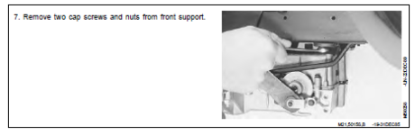

Did you remove the two bolts at the front of the transaxle?

Yes I removed all the nuts and bolts. The problem stems from the threaded U bolt used to hold the transaxle to the mower.
I heated and cooled the aluminum casing covering the bolts and even sprayed with Kroll oil. If it does not come loose over night with a little persuasion wicrow bar and 10 lb hammer inwilll be forced to remove the sides of the frame and cut the u bolt apart andfree up the transaxle.
