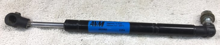

Got the strut out and it appears to be fine and the end has pulled off? It's threaded and I see no damage to the threads male or female?

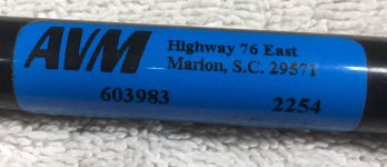

Here is the label on the strut if you want to order one.

The strut looks OK?
But since that end came off once already I have a feeling it will pop off again. But after some digging I found you can replace just the ball stud snap fitting very cheaply! Plus the after market ones do have steel threads on the female insert. This are M6 size and they come in several sizes. Paid about $14 for 5 of them. Called gas spring end fittings

Just a follow up but the replacement end is working fine with the OEM cylinder.
