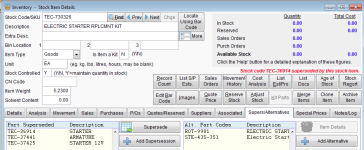

Thanks, IL. I got 26 years out of it, not bad. But curious- do you think that would account for why I am getting only 6-7 v with started having been mounted on the mower? What would cause that? Now, where to buy a new one......There are 2 #'s listed on back of the starter- on top is the 36914, and below it is 38026. Do you know which # is the starter item/code #, for searching the correct one? Thanks!
