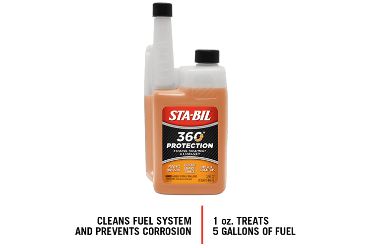

Also, there is no need for a "really good" fuel stabilizer like startron which is more expensive.
Plain old traditional red Sta-bil is what I've been using commercially for almost 14 years.
You don't even need to buy the 360 shield or The ethanol or the boat or any of the other overpriced ones unless you can manage to lower your cost per ounce because those are all more concentrated.
One caveat to all of this though.
I DO NOT use at the lowest recommended dosage which for regular sta-bil is 1 oz for every 2.5 gallons.
This is what they used to say for regular maintenance use.
Then, they had a pink one inch wide box across the back of the label on the full size bottle that said:
"For long-term storage up to 2 years, use at a ratio of 1 oz for every gallon of fuel."
They stopped putting this on there 8 or 10 years ago probably because there were too many jackholes calling up in 1 year, 11 months and 29 days wanting their money back because their engine wouldn't start because they left them sitting out in the rain or their gas can had water in it etc.
I have always and only used the one ounce per gallon ratio and you should ALWAYS AND ONLY put the one else into an empty gas can and then put your fresh fuel into it from the gas pump at the station.
