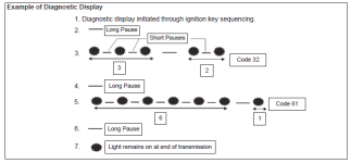

W
wyatth
Hey not sure if anybody can help me on here but I've got a 2011 scan turf tiger and it keeps having check engine light flash codes but I can't seem to find out what's wrong with it the code is long long short short I can't seem to find the codes anywhere either
