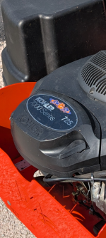

My Bad Boy MZ Magnum runs for about 20 mins then stops. It starts to sputter like it's running out of gas then quits. I have a full tank of gas in it. I'd let it sit for about 10 to 15 mins, start it again and the same thing happens. Runs for a bit then quits. Fuel pump? Fuel filter? Carb issue? Any suggestions where I should start? Thanks!

Does it have a Yamaha engine on it? If so, get rid of it.
